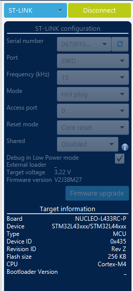

0693W00000LyEzqQAF.pngThank you very much! I should have provided more information.
I'm using ST Link V2 4-wire debugger to flash my board (self designed). I noticed that, if I lower down the "Frequency", then it can sometimes successfully flash (in this screenshot the frequnecy is only 15kHz).
When I select higher frequency, i got error like "Error: ST-LINK error (DEV_TARGET_CMD_ERR)".
When I select even higher frequency like 4000kHz then it can not connect at all and shows "Error: No STM32 target found!"
Therefore I would assume that the "write protection" error is a fake error, which is caused by disturbed signals between my board and the debugger.
Do you have any extra comments please? E.g. do we have any guides or application note about the 4 wire SWD debug port design?

Problem is solved by using another vendor's ST-LINK V2 USB dongle.
Had a similar problem with a particular STLink-V2 clone:
https://www.mikrocontroller.net/topic/515218
The problem was a 1k2 pull-down connected to SWCLK (rather insane, I'd say) or more likely bad PCB design.

Yes, I agree that it is a good idea to have at least 1 original/authentic ST Link USB doggle to verify user board is working. And it is also common that during development there are different versions of PCB boards, multiple debug/flash connectors on PCB etc, therefore it is normal to have ST Link USB doggles from different vendors.
One more comment: it seems the cable length between PCB and doggle is critical too. The shorter, the better.
