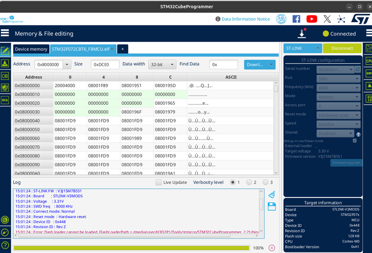

I just installed STM32CubeProgrammer v2.17.0 on Linux.
When I connect to the board (tried with several different ones), I get the following error;
flash loader cannot be loaded. FlashLoaderPath = /home/[yadayada]/bin/FlashLoader/0x
I can read the flash, I can do everything, with the exception of flashing. This fails.
I first thought it might be a truncated log message. But when I just copied any of the loader files and gave it the file name "0x", I didn't get the error message. So it really looks for a file named "0x". It looks like in the code, the assembly of the file name (all the files match the pattern 0x*.stldr)

For now, you can create a copy of the corresponding file from "0x<your_device_id>.stldr" and rename it to "0x" in the "STM32Cube\STM32CubeProgrammer\bin\FlashLoader" and try reconnecting again.

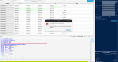

I have exactly the same issue with STV3MOD.  Ubuntu 25.10.
Actually, I wrote code I against the  STV3MOD libraries and it works fine, for example for using the CAN interface.
But when using SWD I get this same error.  Tried v 2.16, 2.18, 2.20 and 2.21. I Also need to start the programmer with sudo otherwise it does not detect the STV3MOD.
Using the programmer usingh USB with the same target device (STM32F072) with STprogrammer works fine.
Copying the file  $ cp 0x448.stldr 0x.stldr did not fix it
I went back to an older copy I had installed  2.14 and everything works fine with STV3MOD. So 2.14 seems the better version to use when using STLINK.
Hello @debugging ,
Use this instead as this workaround requires the file to be named " 0x " without any file extension.
cp 0x448.stldr 0x
We will keep you updated as soon as this issue is resolved.
