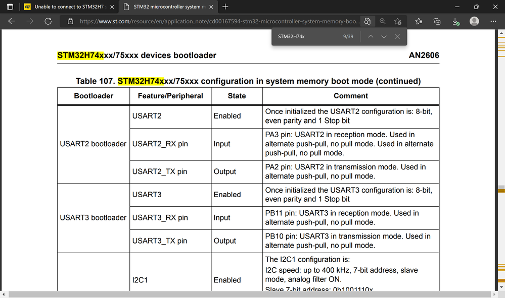

I have been working with STM32H753 device. I was able to boot into the system booltoader of the Nucleo board. Cube Programmer was able to detect and connect through UART.
But, I am unable to connect the Cube programmer in our custom board. Both BOOT_ADD0 and BOOT_ADD1 were set to 0x1FF0. After booting, I connected J-Link to verify that the PC is at 0x1FFx series addresses.
Looking further, whenver I halt and run the CPU through J-Link, the PC seems to be at address 0x1FF0AAF0 and the CycleCnt is increasing.
I am not sure what could be possibly wrong.

You need use exact pins and config described in AN2606 for example
‎2022-06-12 10:49 PM
Hi, thanks for the response. I did use the mentioned pin for USART1 - PA9 and PA10 from AN2606. The same set of pins were working on the Nucleo, but not in our custom board.

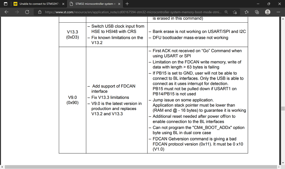

‎2022-06-13 6:52 AM
You meet all this
‎2022-06-14 4:19 AM
The PB15 was set to GND in our case. And changing it, solved our issue. We are able to connect to the bootloader now. Thank you very much.
