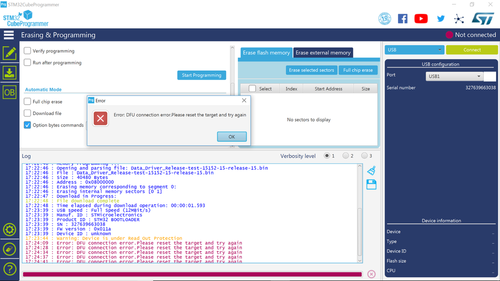

Unable to connect (& hence flash the firmware) the STM32-Cube-Programmer with STM32-target-board in USB-DFU-mode if loaded firmware is read-protected.

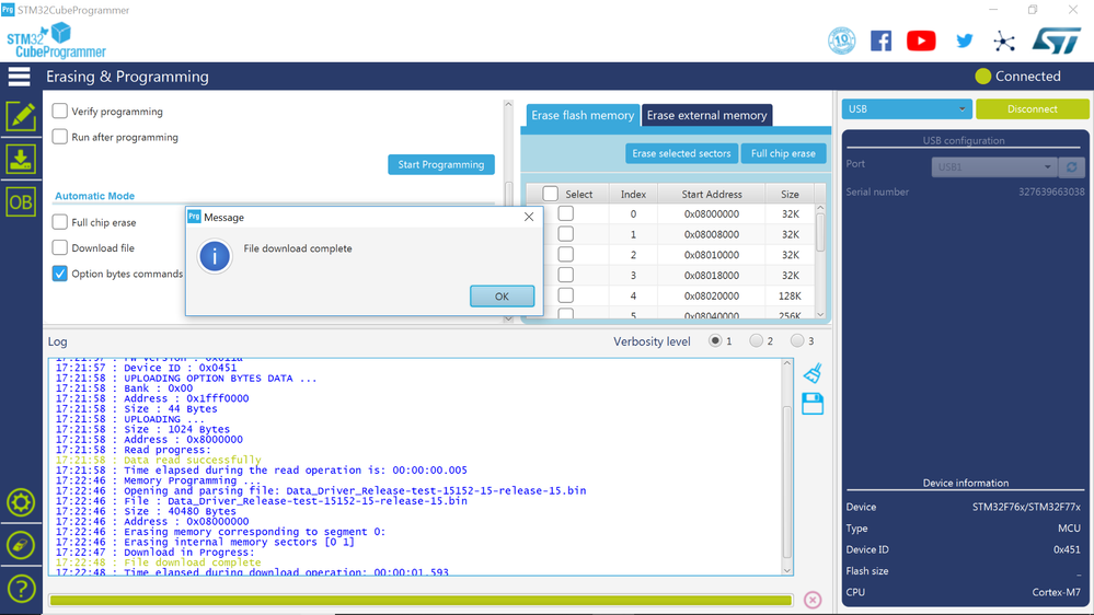

1) I am able to connect the STM32-Cube-Programmer in USB-DFU-mode if existing or loaded firmware in to STM32-target-board is not read-protected.
Image-1: Able to connect with target board
Image-2: Able to load firmware in to target board

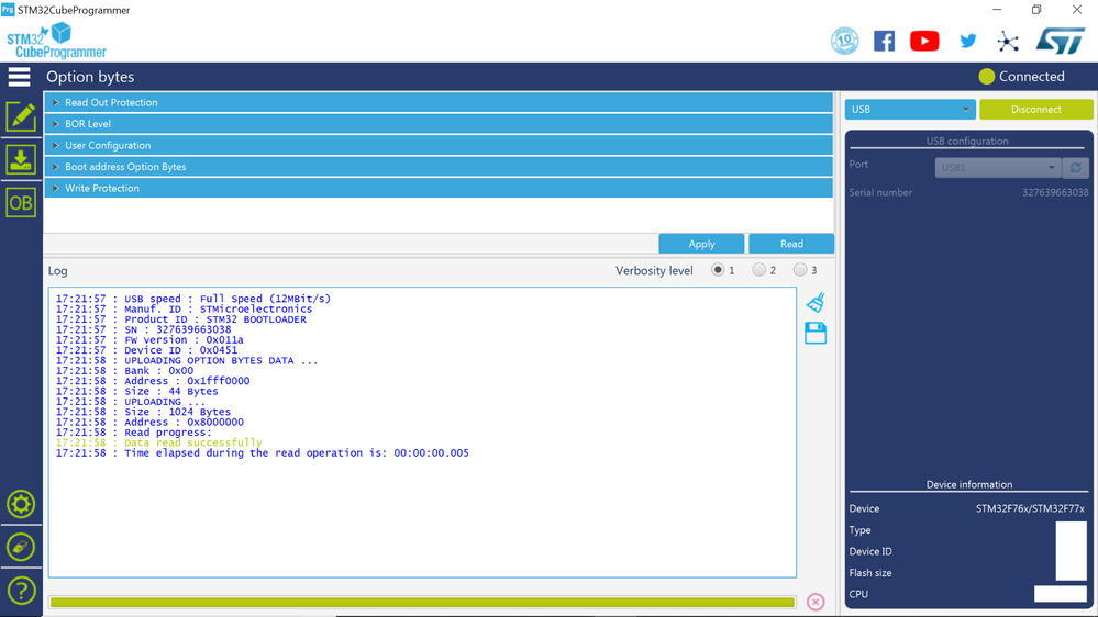

2) I am not able to connect the STM32-Cube-Programmer in USB-DFU-mode if existing or loaded firmware in to STM32-target-board is read-protected.
Image-3: Not even able to connect with target board0690X000009Z7rUQAS.png
In this case I am keep getting the DFU connection error,
How to resolve this application bug.

Can you try another dfu program, as Tormod Volden dfu-util? Does "dfu-uti -l" list the the device when in DFU mode and protected? Then you can erase and rewrite the option with dfu-util.
LPosl
I have exactly the same case with STM32F042 and current STM32CubeProgrammer tool. I'm new to STM32 - my first design now. Tried on 2 PCs. I wasted time on trying a few tools, DfuSE does not see anything, dfu-utl see the chip but I had no clue how to remove the lock. Finally I went to CubeProgrammer folder, and toticed that there is command line version of the tool which I run with following command:
STM32_Programmer_CLI.exe -C port:usb1 -rdu
and got device back in read Level 0 protection
Yes, That's correct, STM32 uC Read out protection can be disabled in usb + dfu mode with command line interface​ only using
STM32_Programmer_CLI.exe.
