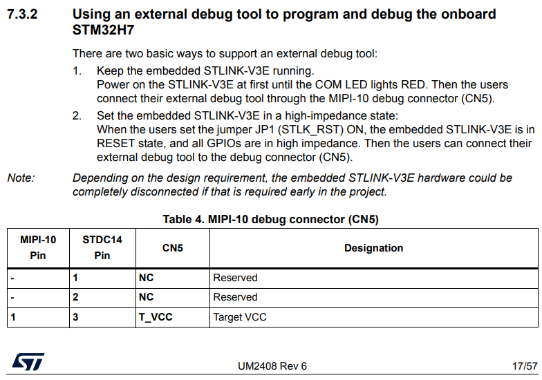

@Domy_ST wrote:
I'm not sure if I will have access to the SWD using the STDC14 - MIPI10 connector.
How to do this is described in the User Manual:
https://www.st.com/resource/en/user_manual/um2408-stm32h7-nucleo144-boards-mb1363-stmicroelectronics.pdf#page=17
also via: https://www.st.com/en/evaluation-tools/nucleo-h755zi-q.html#documentation

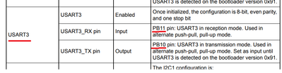

Did you use the same resource needed by the UART that are indicated in the AN2606 "Introduction to system memory boot mode on STM32 MCUs"?
USART3 needs PB11 and PB10 for the bootloader:
While in the NUCLEO board is connected to PD8 and PD9 as indicated by the schematic:
So you need to wire and connect PB10 to PD8 and PB11 to PD9, so the STLINK-VCP will be connected to the USART3 and use the ST bootloader.

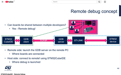

PS:
Note that it is possible to do SWD debugging remotely, if that's what you're worried about:
I've already said that.
