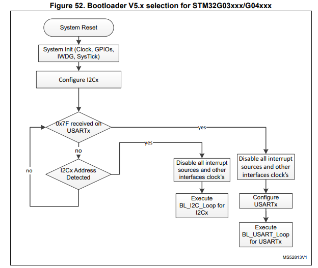

Actually, yes. I'm using the MCU to monitor and control a power system and it has a lot of A/D inputs to sense current and voltage. USART1 is configured for RX/TX but USART2 (PA2/Pin 9 & PA3/Pin 10) is not used for comm but used instead to sense a voltage and a current. Under normal reset, the voltage on PA2 will be max value (on/full range) and the current sense voltage on PA3 will be minimum value (off/no current). I thought that during boot it would look at USART1 first then USART2. If USART1 had a valid response, then it would ignore USART2. Looking at AN2606 more closely, Fig 52 (below) indicates it looks at USARTx. Which could mean a variety of things. Also, I assume that the I2C pins don't matter as they aren't looked at until after USARTx. They also are being used to sense other signals. Even though I'm pin limited and will eventually need to use the USART2 pins for A/D, I'd like to troubleshoot for future revisions. Do the USART2 pins need to be pulled low (white wire) or can they float (e.g. can I cut their traces)? Thanks.
The main consideration is activity on the UART-RX pins that the device might be monitoring for connectivity. The 0x7F data pattern is not received by a UART, but the bit timing is measured with a TIM to establish a baud rate. Signals on watched UART-RX pins will therefore be problematic as the first contact will establish which the user intends to connect on.
