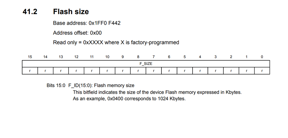

expected: tools report 1Mb flash
actual result: tools report 2Mb
note wrong in bottom-right corner

Hi @arro239 ,
Try to read STM32F75xxx and STM32F74xxx advanced Arm®-based 32-bit MCUs - Reference manual The Flash register size @1FF0 F442 .
USB DFU protocol inside STM32 boo-loader can not read that address so the Cube Programmer is guessing it using the superset device flash size.
Hope it helps.

All the Die have 2MB fabbed, they test half and store that number in the 0x1FF0F442 location. This doubles the through-put of the tested, and allows from price stratification via different SKU
The STM32 Cube Programmer reads that via the SWD/JTAG interface, the DFU boot loader in ROM, doesn't change the reported memory size descriptors sent via USB.

Dear @Tesla DeLorean ,
Indeed “ the DFU boot loader in ROM, doesn't change the reported memory size descriptors sent via USB”,
Bootloader is not reporting the right descriptors reflecting the current memory size and configuration and so we are in such situation where the CubeProgrammer is only guessing that or any other Software GUI by the way . It should be reported in our AN2606 as USB DFU known limitation on this case . Thanks for the understanding.
