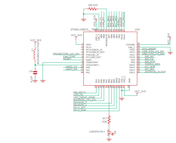

2022-09-06 5:38 AM
Hi
The relevant part is shown in the image. we have the same copy with different l4q5 controller working perfectly. The problem is only with this latest set of 10 numbers that we purchased recently.
Schematic wise all connections are right and tested
Thanks for your support

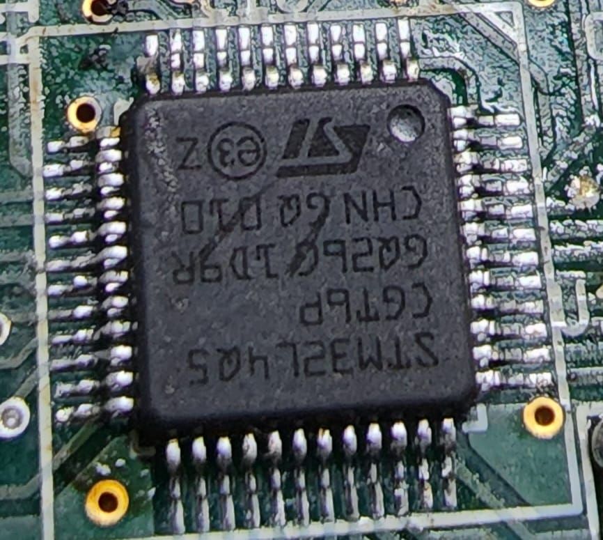

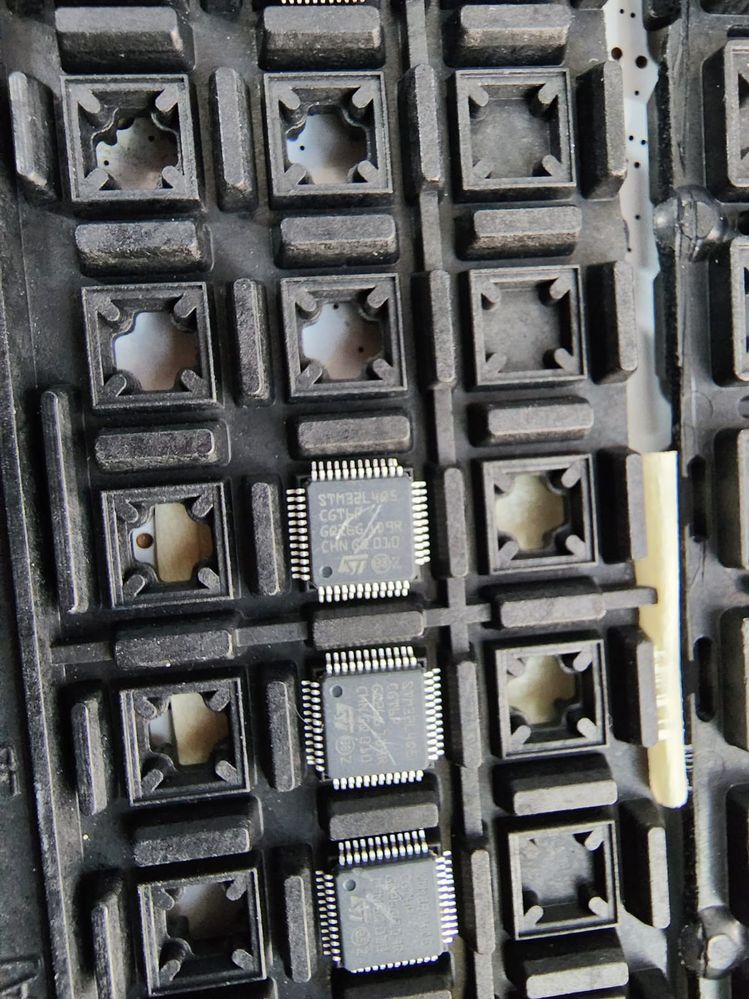

2022-09-06 6:16 AM
So perhaps counterfeit?
Attach a large, clear and in-focus picture of part.
2022-09-06 6:21 AM
the 2 images attached one is close up(assembled piece) and other one is IC packed one
2022-09-06 2:54 PM

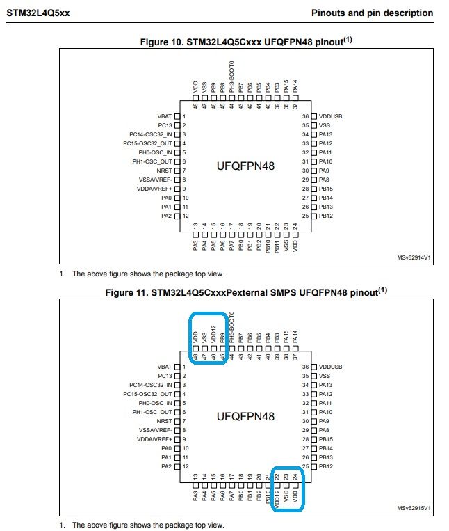

That's a P suffix device, isn't that wired/powered differently?
2022-09-06 3:09 PM
STM32L4Q5CGT6 Expected/Wanted
STM32L4Q5CGT6P Purchased (Less Popular, More Available)
https://www.st.com/resource/en/datasheet/stm32l4q5ag.pdf
I personally would have chosen a different Marking/SKU strategy, but..
