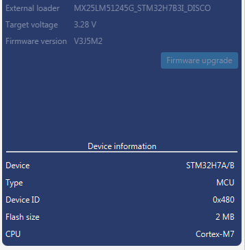

I believe the correct External Loader is being picked up see image below.

If your Firmware is at V3J5M2, then it is already downgraded. If it is at V3J7M2, then click the Firmware Upgrade button in CubeProgrammer which should downgrade the FW.
In STM32CubeProgrammer, under External Loaders. there should be a check mark in the Select box for the Board labeled STM32H7B3I. This should be for the '-DK'.

"In STM32CubeProgrammer, under External Loaders. there should be a check mark in the Select box for the Board labeled STM32H7B3I. This should be for the '-DK'"
Yes, for the STM32CubeProgrammer I have selected the correct External loader for the STM32H7B3i-DK board from the "EL" selection.
