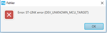

STM32G431 connect over JTAG
  • December 18, 2020
  • 10 replies
  • 4384 views
I try to connect to a STM32G431 Device over JTAG. I got the following error. Has someone a solution for this error?

Did you upgrade to the latest tool version like STM32CuberProgrammer 2.6?

Yes I am using V2.6

Custom board? Nucleo32 works here as expected. What probe?

It is a self developed board. The JTAG connection works with an J-Link but not the ST-Link and STM32CubeProgrammer. Just a connection over SWD

Communication errors? You can lower the clock speed and re-check.

Firmware on the STLink recent? All STlink match JTAG ID against an internal list and reject parts they do not know(yet).

Firmware on ST Link is recent

Does connect under reset work?

No, it doesn't work

Double check your wiring, the problem is with 99.9% on your side. Get out the scope or LA and look at the signals.
