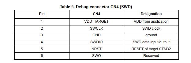

@Sco​ On the R22 resistor, I have 0V. But I use an old ST-Link cutted from an STM32F030R8 nucleo board. And this resistor is connected to the pin 6 (SWO - Reserved)
0693W00000DmPPiQAN.jpgSo, the component denomination could be different.
If I compare a nucleo schematic and mine, the "AIN_1" signal seems to be connected to the debug connector (pin 1) through a resistor not fitted. On my ST-Link, it seems to be the resistor R9 (not fitted) and I have 3.3V on it.
