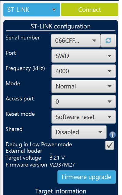

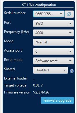

And now, I'm not able to connect to the slave MCU using STM32CubeProgrammer.
I have "Error: No STM32 target found!" and "Voltage: 0.01V" even if I have 3.3V on the pin 1 of the SWD connector and a high level on the NRST pin. I also tried some differents "Mode" and "Reset mode" configuration without success.

On the pin 1 of CN11 connector of the ST link I have 3.3V. On the pin 5 of the connector (NRST pin), I also have 3.3V.
So the MCU is correctly powered and no in reset. Even with this configuration, I can't connect with the STM32CubeProgrammer

I updated the STM32CubeProgrammer to the latest version and I tried with a lot configuration (Mode and Reset mode).
But I always have the same error.

For the target voltage = 0.01V, you can have a confirm that, if "AIN_1" is "0V" or"1.6V". You may measure this power in R22.
Target voltage: 0.01V suggests the chip doesn't have power, despite whatever you're measuring.
How are you powering the board? Note that the debug connector does not provide power.
