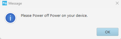

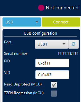

I am doing some initial development for a device that will use the STM32F072B MCU on its Discovery board. The device will need to have the ability to be programmed over USB. The Discovery board User manual section 5.8 states that this can be done if BOOT0 is pulled high. I do this and try to connect by using the STM32CubeProgrammer that detects that there is an STM32 Bootloader but cannot connect because of read out protection and suggests to turn on the Read Unprotect option. If I do this, and try to connect again, a new pop-up shows up that tells me to power off and power on my device. Nothing changes if I plug it out and in or press the reset button.

16:21:45 : Warning: Device is under Read Out Protection
16:21:45 : Device Read Unprotect requested
What could I do to solve this, is it even possible to do it like that?

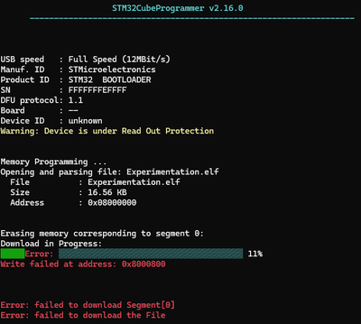

I tried this from a different computer and I managed to do it but it was kind of buggy (sometimes it crashes in GUI, always works in CLI) but it did work. If I run it the programmer from the command line it sometimes gets further than just requesting protection:
Note "unknown" Device ID so it doesn't even work that far.

Hello @waratu ,
I apologize for the delayed response.
We are aware of this issue and it is currently under investigation.
Internal ticket number: 188241 (This is an internal tracking number and is not accessible or usable by customers).
As a temporary solution, we recommend connecting your MCU via a HUB rather than directly to the PC.
