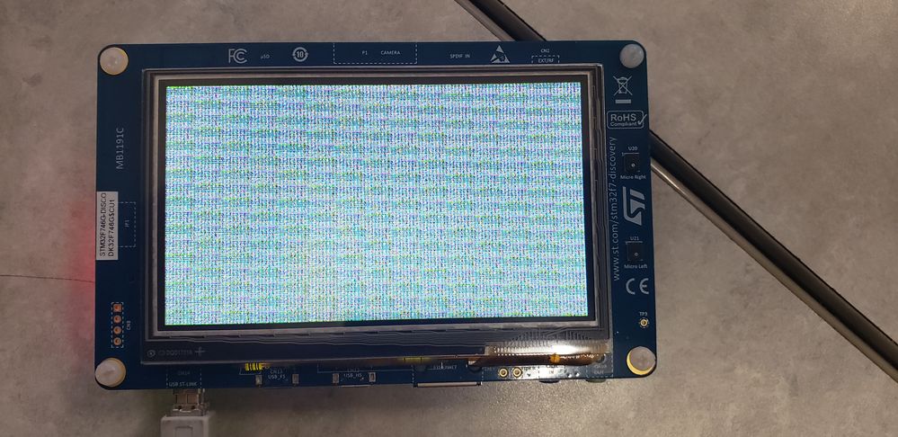

Thanks for this, unfortunately the results with this .stldr are the same as before. I used a new DISCO board and programmed only with STM32CubeProgrammer with the following results:
  15:47:54 : File download complete
  15:47:54 : Time elapsed during download operation: 00:02:10.970
  15:47:54 : Verifying ...
  15:47:54 : Read progress:
  15:48:00 : Error: Data mismatch found at address  0x90000014 (byte = 0x00 instead of 0xD8)
  15:48:00 : Error: Download verification failed
  15:48:00 : RUNNING Program ...
  15:48:00 :   Address:      : 0x08000000
  15:48:00 : Application is running, Please Hold on...
  15:48:00 : Start operation achieved successfully
It says it started successfully, but based on the previous discussion I think this would be the STM32F746 Flash, not the external memory.
