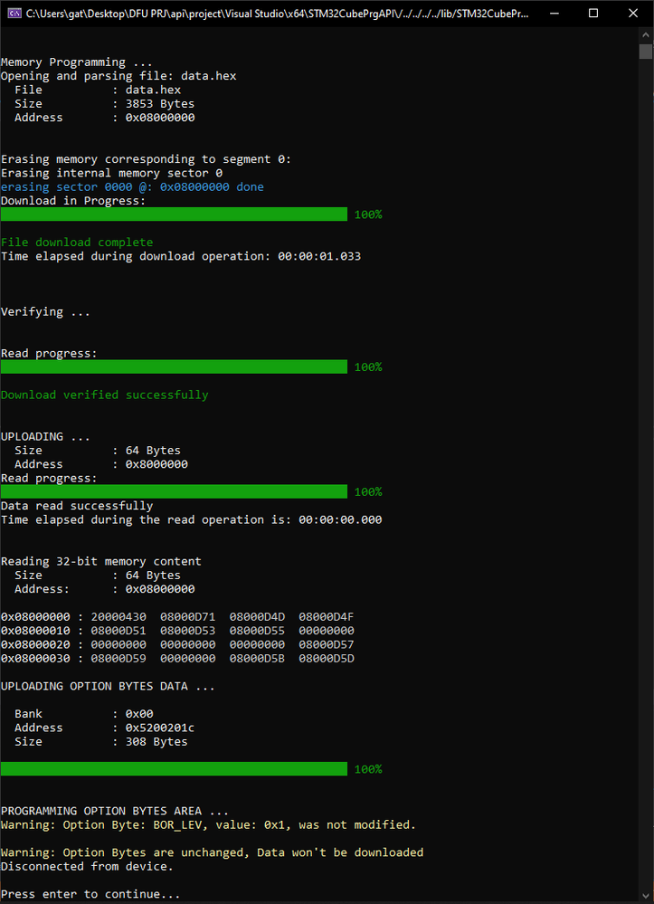

I put my STM32H743XI in Bootloader mode and launch STM32Cube Programmer USB example on VS and got :
0693W0000059bznQAA.pngI have two question :
  • Where does this error comes from and how to fix it ?
  • Can I skip option bytes programming and still flash my MCU ?
Regards
Mike_ST
Are you talking about the warning on BOR level not being updated ?
If so, it is not an error and you can skip it if you don't need to program the BOR Level.
