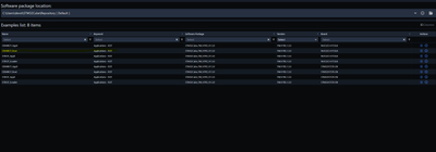

When I try to import the sample project “OEMiROT_Boot”, I get exit code 255.
Error:
2026-05-20 15:46:46.511 [Error] [ide-project-convert] ENOENT: no such file or directory, copyfile 'C:\Users\devst\STM32Cube\Repository\STM32Cube_FW_H7RS_V1.3.0\Projects\NUCLEO-H7S3L8\Applications\ROT\OEMiROT_Boot\STM32CubeIDE\utput.ld' -> 'd:\Projekte\Test\test\NUCLEO-H7S3L8_OEMiROT_Boot\utput.ld'
2026-05-20 15:46:46.567 [Error]  [ide-project-convert]: Project conversion failed with exit code: 255.

This error looks strange to me because, unless I am wrong, STM32Cube_FW_H7RS_V1.3.0\Projects\NUCLEO-H7S3L8\Applications\ROT\OEMiROT_Boot\STM32CubeIDE does not exist. I just see 2 readme file in OEMiROT_Boot folder. So I do not understand how it can be listed in the Examples Browser.
