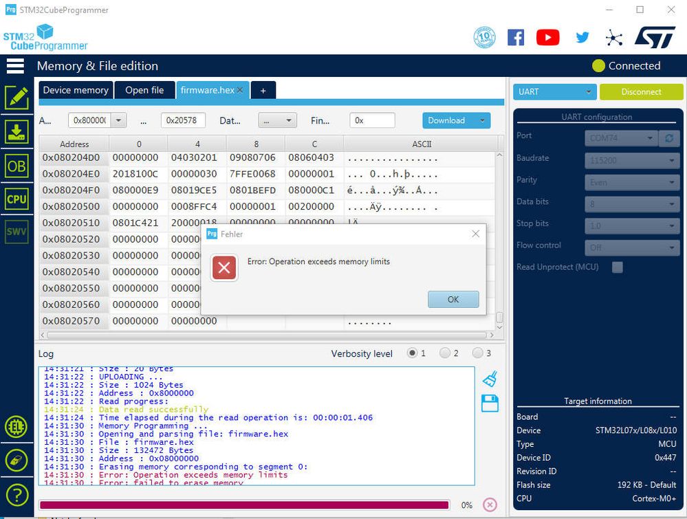

ST32L081 can not be programmed with firmware bigger than 128k with CubeProgrammer and UART-Bootloader.

Oh, sorry. It is a STM32L081CZT6 with 192kiB
Mike_ST
If you don't mind, please submit screenshot of the STM32CubeProgrammer.
And copy/Paste log window content including error messages if any.
VoWa
Here is the Screenshot
And here the Log-File:
14:31:18 : Serial Port COM74 is successfully opened.
14:31:18 : Port configuration: parity = even, baudrate = 115200, data-bit = 8, stop-bit = 1.0, flow-control = off
14:31:19 : Timeout error occured while waiting for acknowledgement.
14:31:19 : Activating device: OK
14:31:19 : Chip ID: 0x447
14:31:19 : BootLoader protocol version: 3.1
14:31:21 : UPLOADING OPTION BYTES DATA ...
14:31:21 : Bank : 0x00
14:31:21 : Address : 0x1ff80000
14:31:21 : Size : 20 Bytes
14:31:22 : UPLOADING ...
14:31:22 : Size : 1024 Bytes
14:31:22 : Address : 0x8000000
14:31:22 : Read progress:
14:31:24 : Data read successfully
14:31:24 : Time elapsed during the read operation is: 00:00:01.406
14:31:30 : Memory Programming ...
14:31:30 : Opening and parsing file: firmware.hex
14:31:30 : File : firmware.hex
14:31:30 : Size : 132472 Bytes
14:31:30 : Address : 0x08000000
14:31:30 : Erasing memory corresponding to segment 0:
14:31:30 : Error: Operation exceeds memory limits
14:31:30 : Error: failed to erase memory

With the CLI it is the same. FW with <128kiB works, >128kiB does not.
>>> STM32_Programmer_CLI.exe -c port=COM74 -d firmware_big.hex
                       STM32CubeProgrammer v2.5.0
Chip ID: 0x447
Device name : STM32L07x/L08x/L010
Flash size  : 192 KBytes (default)
Device type : MCU
Device CPU  : Cortex-M0+
Opening and parsing file: firmware_big.hex
  File          : firmware_big.hex

Very weird, is that the "size" of the .HEX file on the computer, or the span of the content it describes internally?
Anything interesting in the .MAP file about the highest 0x08000000 region address?
VoWa
@Community member​
No that is the size of the binay content of firmware itself. The .hex file on the comuper is about 3x bigger.
Can you clarify what you mean with "interesting" ? The firmware code iself is > 128 k. Programming via SWD interface is working properly.
