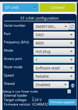

4.1. STM programmer connection settings
4.2.

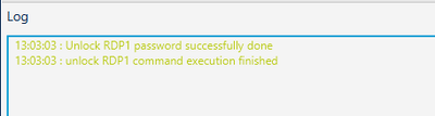

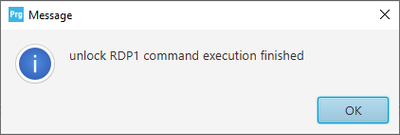

 I have written the OEM1 password and pressed on "unlock RDP" button“
The following status was observed

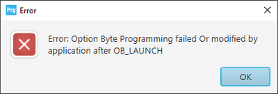

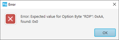

4.3. Changed the Option bytes values [ changed the RDP level to 0], and performed OB write by "apply" button
4.4. The following error was noticed

1) Should I modify any settings of STM32 programmer prior to connecting the target, aside from those specified procedures which is specified in section 4.1 of the STM programmer connection settings?

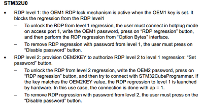

2) In the UM2237 User Manual [section: 2.9.2 RDP regression with password], it states, "write the OEM1 password, and press the 'RDP regression' button," yet there was no 'RDP regression' button available. Does this imply that 'Unlock RDP 1' is meant instead?
3) When the target is connected in hotplug mode on access port 1, the OB data was not read, and everything was recorded as 0. Therefore, I believe this is the cause of the OB write failure.

4) Even if I enter an incorrect OEM1 password, the operation still succeeds, indicating that "Unlock RDP password successfully done." Does it not verify whether the provided password matches or not?
Did you write 0 or 0xAA to it , to set it RDP = 0 ???
Because it complains: option byte now : 0x0 .
Written 0xAA, to make the regression
