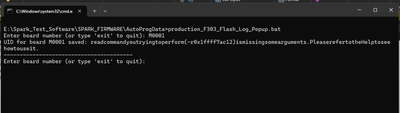

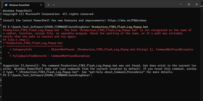

1. Following is , When I run it with Windows PowerShell
2. When I run in CommandLine

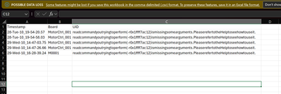

3. CSV LogFile

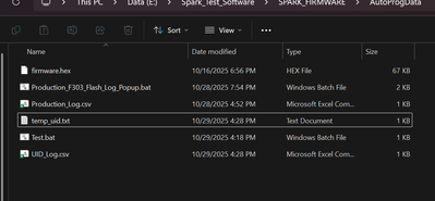

4. Folder view on my PC , all file in same Folder

bsuthar
Okay, Bob S
Here is the Batch Scripts , FYR. Error windows was shown in Previouse Post , 2nd Image.

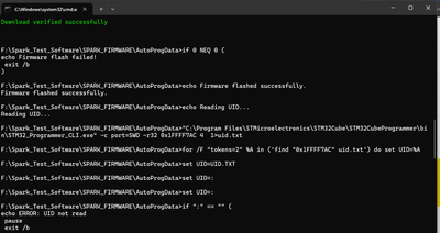

Considering your suggeston for breaking down code path  , i have removed the Wrapper and just rewrite Short batch file step by step.
See the New Batch file as Below , Firmware Download Works and RDP1 set works fine. But, UID Read/Write Fails

Outpu on Command windows :
