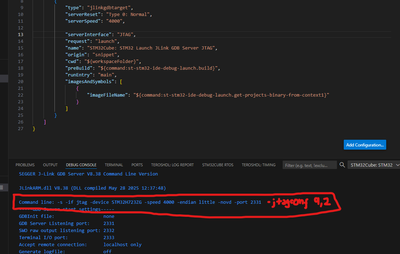

I can't seem to find the launch configuration setting to specify a device in the JTAG chain by its position and IRpre length. I'm using a J-link programmer and I can usually do this from the command line by passing the -jtagconf x,y argument to the J-link executable. However, the debug console in VScode shows that the debug launch config called the Segger J-link GDB server without this argument. I can't seem to find how to make the debug config to append this to the J-link server call

The attribute serverJtagCfg will be available in the next delivery (planned for the end of November).
In the meantime, you can use the generic debug configuration to pass the -jtagconf argument in the serverParameters attribute.

Hi @Visques ,
Thanks to the latest 3.7.0 release, the attribute for JTAG configuration is now available.
"serverJtagCfg": "<IRPre>,<DRPre>",
With the tooltip:
Regards,
Flo
Thanks so much!
Btw: Not sure if the information box should say TDO instead of TDI? Usually IRPre and DRPre are counted from TDO
