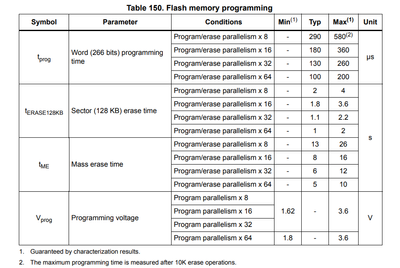

We believe that the original issue on STM32H743 you are facing in this post Solved: Process Change Information (STM32H74x/75x - Microc... - Page 2 - STMicroelectronics Community  is linked to "Timing of Erase Operation" not properly send by impacted MCU.  at this step, we suggest you get direct contact with our ST Support team in your location to in touch with you and work closely on your setup.
and in particular to see the Timing between each command and waiting the "max timing" of Erase sector  as below - extract from Datasheet:
in STM32L4 series, it is not the same timings .  Hope it helps you
