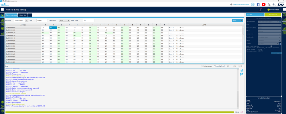

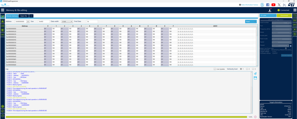

tested an MT25QL NOR flash using STM32CubeProgrammer and an external loader.
  • On the STM32 eval board (same MCU + same flash), read/write/erase works perfectly.
  • On my custom board (same schematic and connections verified), I see an issue:
Only alternate bytes are written/read correctly
The missing bytes always read as 0x99
Example:
Writing a string → only every alternate byte is valid, others = 0x99

Hello @sravanemedge and welcome to the community;
I recommend you to test an available example like as QSPI_MemoryMapped and use a logic analyzer or oscillator to verify data line activity.
Thank you.
Kaouthar
