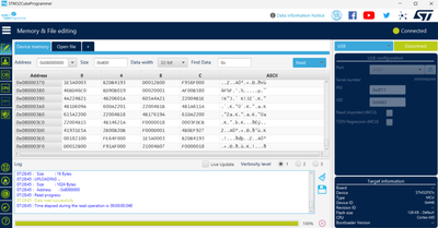

I am trying to connect to the STM32F072C8T6 microcontroller via USB in the STM32CubeProgrammer, however I am getting:
"Device is under read out protection ! If you want to disable RDP please reconnect with Read Unprotect enabled"
So, when I check the Read Unprotect (MCU) checkbox, I get:
"Please Power off Power on your device."
After turning the power off/on, I see the same messages. I cannot connect to the MCU via USB in the STM32CubeProgrammer.
I have tried different versions of STM32CubeProgrammer:
  • v2.16.0
  • v2.15.0
  • v.2.13.0
  • v.2.10.0
  • v.2.8.0
Moreover I tried on second computer with Windows 11 and I have the same issue.
I'm trying to connect my custom board, but I also checked another hardware board (BluePill ) with the same STM32F072C8T6 MCU and it doesn't work either.
Interestingly, using the DFU-util v0.8 program I can connect to the MCU and successfully read/write memory:

Hi All,
New AN26006 Rev70 released , See Table 36 with Known Limitations :
USB bootloader fails on some machines using a high speed controller. The bootloader is detected. but then data transaction fails.
Root causes:
De-synchronization between USB controller and bootloader SW due to the controller high speed transactions. The controller high speed inter-packet delay seems not sufficient for the bootloader SW (based on interrupt routines) to serve all needed transactions (the delay needed by the BL is nearly 25 µs). Some interrupt services are missed. This results in a communication fail, causing Write command to fail.
Workarounds:
  • Add USB HUB between host and the MCU. This relaxes transactions inter-packet delay, and allows the bootloader SW to perform correctly the task.
  • Use USB controller/host that increase inter-packet delay.
  • For new designs, use DFU in user flash memory to fix the issue.

Hello @Draxter
Regarding this issue, we are aware of it and it's currently under investigation.
Internal ticket number: 171192 (This is an internal tracking number and is not accessible or usable by customers).
As a workaround, we suggest connecting your MCU using a HUB instead of plugging it directly into the PC.

@new_earth75 answer from STMicroelectronics support:
In fact, the issue is coming from the USB bootloader state machine which hangs and stuck in busy state.
This issue is seen only on recent machines with high speed USB controllers, and putting a hub resolves the issue.
Other possible solutions :
- Using dfuse
- Using connectors downgrading the USB speed then putting some more latency in the transmission to make it work

@Amine_Jridi thank you. Connecting the board to an external USB HUB solves the problem.
We are unable to understand what is root cause. Why use a USB HUB instead of a direct connection to a computer?
