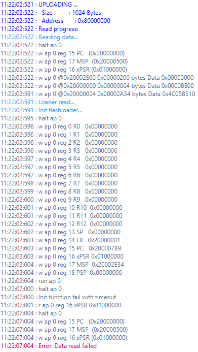

I'm currently trying do make my own external loader for my board Mikromedia Capacitive 7.
I have a STM32F746ZG MCU and the SST26VF064B 64Mbits Flash Memory.
I want to make my external loader in order to store images in my external flash.
I made debug on my Loader_Src file, Init(), Read(), EraseSector() functions work perfectly.
However when I launch my external loader in STM32CubePrg to read my external flash, I fell into a timeout like this :

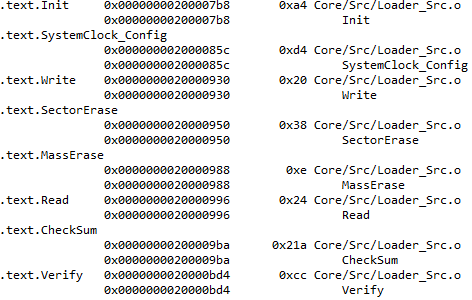

Here are how my Loader_Src functions are mapped in my RAM :
0693W00000Dla5NQAR.pngThe PC value is my Init address, so I expected it to work but not yet !
I have no idea where the error could be from, maybe the RAM mapping, the linker script..

Hi @Maël Lair​ ,
I'm facing exactly the same issue after upgrading from CubeProgrammer v2.4.0, could you find the solution for this?
