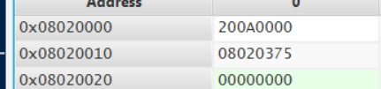

Thanks @Pavel A.​ and @Community member​ for your answers, sadly my problem is still there. I tried to narrow it down more so here it is :
I load a simple blinky application at the address 0x08020000 of my flash using stm32CubeProgrammer :
int main(void)
 HAL_Init();
 SystemClock_Config();
 MX_GPIO_Init();
 while (1)
	 GPIOH->ODR ^= 0x10;
	 HAL_Delay(500);
with the following linker script :
/* Entry Point */
ENTRY(Reset_Handler)
/* Highest address of the user mode stack */
_estack = ORIGIN(RAM) + LENGTH(RAM); /* end of "RAM" Ram type memory */
_Min_Heap_Size = 0x200 ; /* required amount of heap */
_Min_Stack_Size = 0x400 ; /* required amount of stack */
/* Memories definition */
MEMORY
 RAM (xrw) : ORIGIN = 0x20000000, LENGTH = 640K
 RAM2 (xrw) : ORIGIN = 0x10000000, LENGTH = 64K
 RAM3 (xrw) : ORIGIN = 0x20040000, LENGTH = 384K
 FLASH (rx) : ORIGIN = 0x8020000, LENGTH = 1024K
I then made this other small program that jumps to it and works properly :
#define APP_FLASH_ADDR 0x08020000
int main(void)
 volatile uint8_t dummy = 0;
 HAL_Init();
 if(0)
		HAL_FLASH_Program(FLASH_TYPEPROGRAM_DOUBLEWORD,(0x08010000),0x0);
	void (*app_reset_handler)(void) = (void*)(*((volatile uint32_t*) (APP_FLASH_ADDR+4U)));
	__set_MSP(*(volatile uint32_t*) APP_FLASH_ADDR);
	app_reset_handler();
 while (1)
Now, with a change in the condition, it doesn't work anymore. Even if "dummy" is at 0.
int main(void)
 HAL_Init();
	if(dummy)
 while (1)
But in my bootloader, I would like to be able to programm the flash, then jump to the new application. I don't understand why I cannot do both. Do you have any clue for me please ?

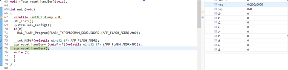

Same when it's global :
void (*app_reset_handler)(void);
int main(void)
 HAL_Init();
 if(dummy)
	HAL_FLASH_Program(FLASH_TYPEPROGRAM_DOUBLEWORD,(APP_FLASH_ADDR),0x0);
 app_reset_handler= (void*)(*((volatile uint32_t*) (APP_FLASH_ADDR+4U)));
 while (1)
