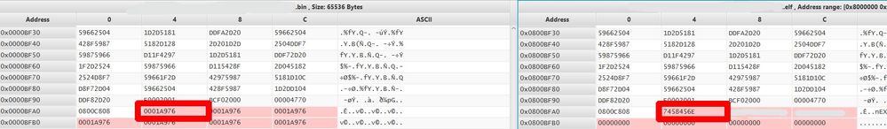

to store my SW build information I defined in the linker file a section with a fixed address. like this:
 /* placing my build information at a named section: */
 .BuildInformationSegment 0x0800F000 :
 KEEP(*(.BuildInformationSection)) /* keep my variable even if not referenced */
This works and creates the section containing the string in the .bin. and .elf.
even when I misplace this part and dont sort it according to its address.
When I load the .elf into the STM32CubeProgrammer it looks like the .map file (or similar information) is used to generate a different binary which, when flashed leads to an error.
Here in the screenshot (some details removed) a difference between the bin. and the .elf is visible. This difference only occurs in STM32CubeProgrammer as the .bin is directly generated from the .elf via arm-none-eabi-objcopy. It occurs on the spot where the section is visible in the .map file:
 0x000000000800bf22 STL_TM_RAM_BckUpBuf_MarchCXStep
 0x000000000800f000 0x60
 0x000000000800f000 0x60 ./Core/Src/production_testing.o
.rodata 0x000000000800bfa4 0x11a8
I know how to fix this in my software (place my section on the correct spot in the linker file) but still find it critical that the STM32CubeProgrammer creates a difference between .elf and .bin and therefore can lead to unexpeced behaviour.
I cant share my code or binaries but it should be reproducable with the linker code above placed somewhere else than in the end of the flash.

I might add the output for readelf to make my point a little bit clearer. Please see below.
Both outputs differ in the position of BuildInform but lead to working binaries:
The bad one:

Best regards,

I now also tried it with the STM32_Programmer_CLI and get the same, bad results. When I flash the .elf and calculate the checksum it is clearly different from when I flash the binary copy of the .elf done with objcopy and the software doesn't run. When I download the flash contents to a binary I can see the same difference as above.
STM32_Programmer_CLI -c port=SWD -d DEBUG_bad.elf -v -checksum
 Flash Memory checksum calculating ...
 Flash memory [0x08000000 : 0x08010000] - Checksum : 0x005EAFAA
arm-none-eabi-objcopy -O binary DEBUG_bad.elf DEBUG_bad_objcopy.bin
STM32_Programmer_CLI -c port=SWD -d DEBUG_bad_objcopy.bin 0x08000000 -v -checksum
 Flash memory [0x08000000 : 0x08010000] - Checksum : 0x0049BBDB
