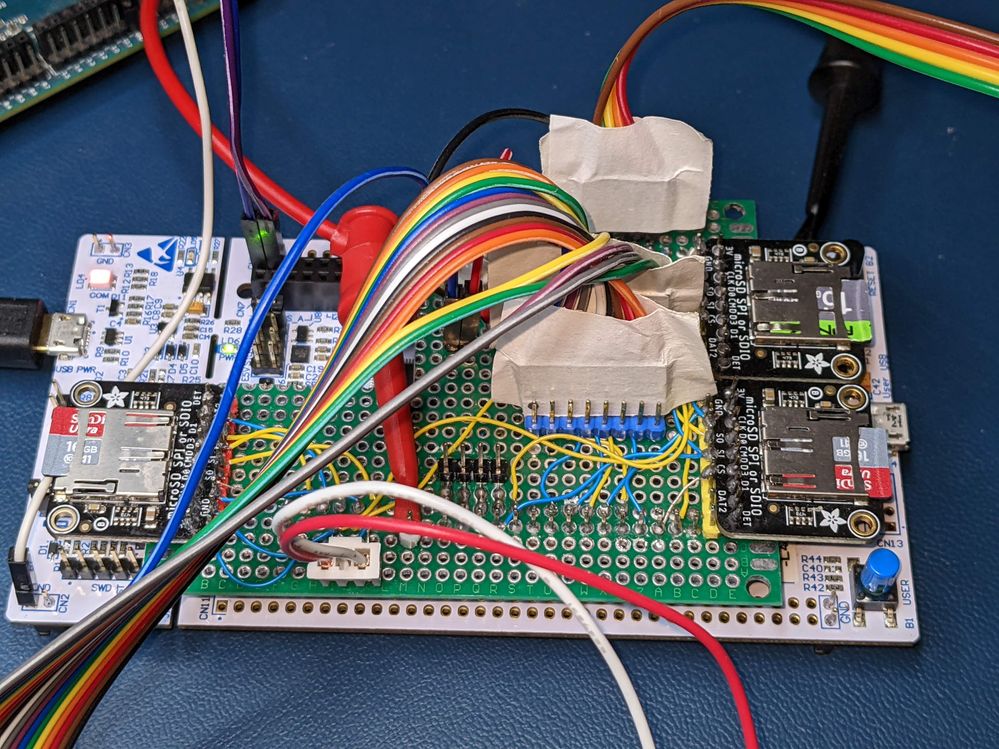

The problem went away for a long time, and then came back one day. I have a daughter board plugged into the Zio connectors, and my new theory is that the cheap breakaway header strips that I got from Amazon are making a poor connection somewhere in the expansion connectors. The daughter board is not even involved in the path from the PC->USB->ST-Link->STM32; except that when I have it configured for external power on VIN, I am feeding that in through a pin on the daughter board that is connected to a pin that goes into the expansion socket. (In that case, I move JP6 from STLK to VIN, so the only power to the non-ST-Link part of the Nucleo is coming through VIN instead of USB.) What I have done for now is to carefully clean all the pins with isopropyl, and then I sprayed some DeoxIT D100 "more than a contact cleaner" into the sockets. If I have the problem again, the first thing I will try is reseating the board. The problem went away when I reseated the board, and things have been running well on external power for weeks now. I will stick to gold-plated Berg strips from now on.

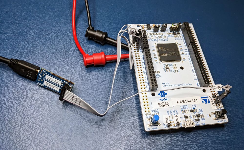

2023-04-26 8:54 AM - edited 2023-11-20 9:13 AM
The problem kept coming back, intermittently. I finally resorted to sawing off the NUCLEO's integrated ST-LINK/V2-1 debugger/programmer, and connecting a STLINK-V3MINI. I have also used the STLINK-V3SET. I have never had the problem again, and it has been months now.
