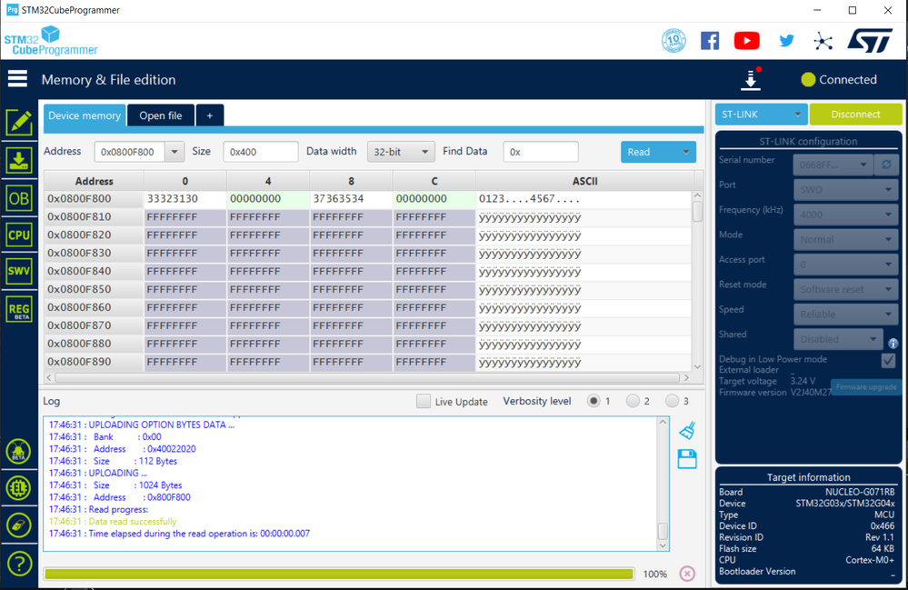

I wish to store data in the flash memory of my STM32G030C8T6 microcontroller. The issue I am facing is that my data is not being stored in contiguous memory banks, but rather the banks are being skipped, as seen from the image.

G0 require the Flash memory to be written in units of 64-bit words - check the manual. You cannot write it by words (32-bit), only in pairs.

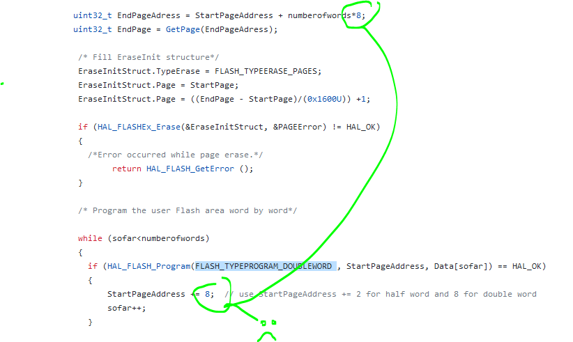

you hardcoded a bunch of 8s and 4s , im sure you skipped/swapped one of those

uint32_t EndPageAdress = StartPageAddress + numberofwords*4;
and
StartPageAddress += 8;
are yielding the same result.
โ2023-01-23 1:23 AM
I am not saying the value shouldnt be 8/4, i meant if those numbers are harcoded like that there is usually a big chance you messed up some.

Look at the EraseInitStruct.Page = statements in your code, one after another. They don't seem to be correct.
โ2023-01-23 5:45 AM
Thanks @gbmโ ,
I think I have got where the issue is.
I am doing:
EraseInitStruct.Page = StartPage;
EraseInitStruct.NbPages = ((EndPage - StartPage)/(FLASH_PAGE_SIZE)) +1;
whereas in the example code it is
EraseInitStruct.PageAddress = StartPage; EraseInitStruct.NbPages = ((EndPage - StartPage)/FLASH_PAGE_SIZE) +1;
Most probably this is causing the issue.
The definition of Page is: Initial Flash page to erase when page erase is enabled. This parameter must be a value between 0 and (FLASH_PAGE_NB - 1)
and that of PageAddress is: Initial FLASH page address to erase when mass erase is disabled. This parameter must be a number between Min Data = 0x08000000 and Max_Data = FLASH_BANKx_END (x = 1 or 2 depending on devices).
Can you please suggest an alternative to be used for PageAdress for g0 series, as I am not able to identify what the correct variable alternative to PageAdress could be.
