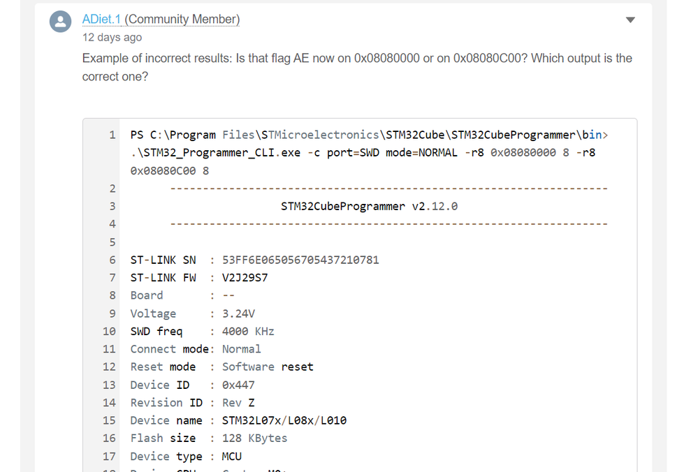

I guess the inconsistency is another ticket.
Hi @ADiet.1​ ,
I mean the issue you talked about here on this post:
Aziz

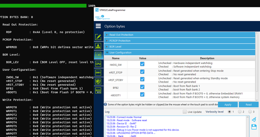

Maybe what I mean is the following:
0693W00000aJTz0QAG.pngChecking the flag BFB2 on UI and command line gives inconsistent results! I have no idea to know which one is correct!
