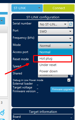

How can I use the STM32CubeProgrammer windows executable to read a memory area without the device resetting?
  • March 10, 2023
  • 23 replies
  • 5856 views
I have been trying to read a memory area as follows on windows power shell:
.\STM32_Programmer_CLI.exe -c port=SWD -r8 0x08080000 8 -r8 0x08080C00 8
but that triggers a reset of the device. I do not want a device reset, I just want to read the memory as specified. How to do that?
Best answer by waclawek.jan
This
should result in debugger connecting without reset. There should be a counterpart to this in the CLI too.

ADiet.1
ADiet.1Author
March 10, 2023
I tried that, but when I use the mode HOTPLUG I get incorrect results! The application returns bytes that are incorrect!!

ADiet.1
ADiet.1Author
March 10, 2023
Just opened a bug report. Something is definitively not correct with the STM32CubeProgrammer application!
waclawek.jan
March 15, 2023
My guess is that this is related to the dual-bank operation and its related flags (UFB maybe?).
With hot-plug, the running program may switch the mapping without knowledge of the programmer, and then it's always questionable, how far the programmer/debugger should force its settings to the application.
