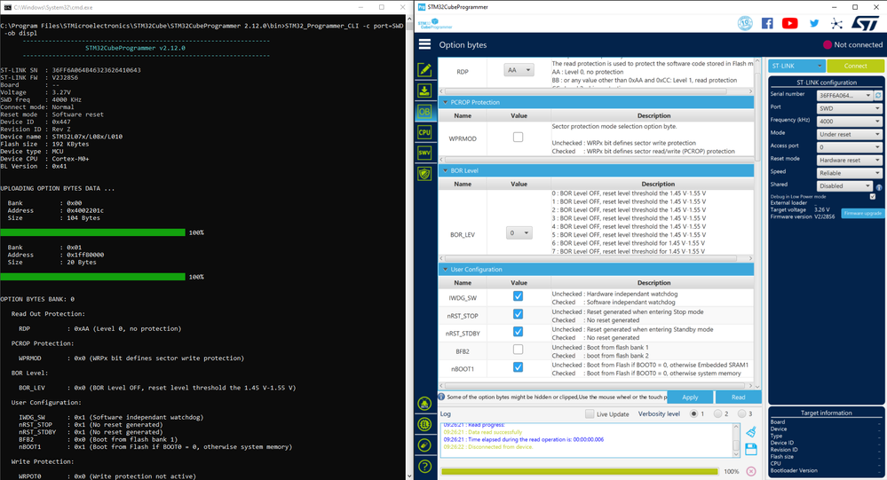

I am using the GUI version and the command line tool to work with a device, but one of these tools has a bug. Checking which bank is use to boot from I get clearly contradictory results. See screenshot. Which tool tells me the bank used to boot from?
CLI: 2.13.0
GUI: 2.12.0 (update not possible; that will be yet another bug report...)

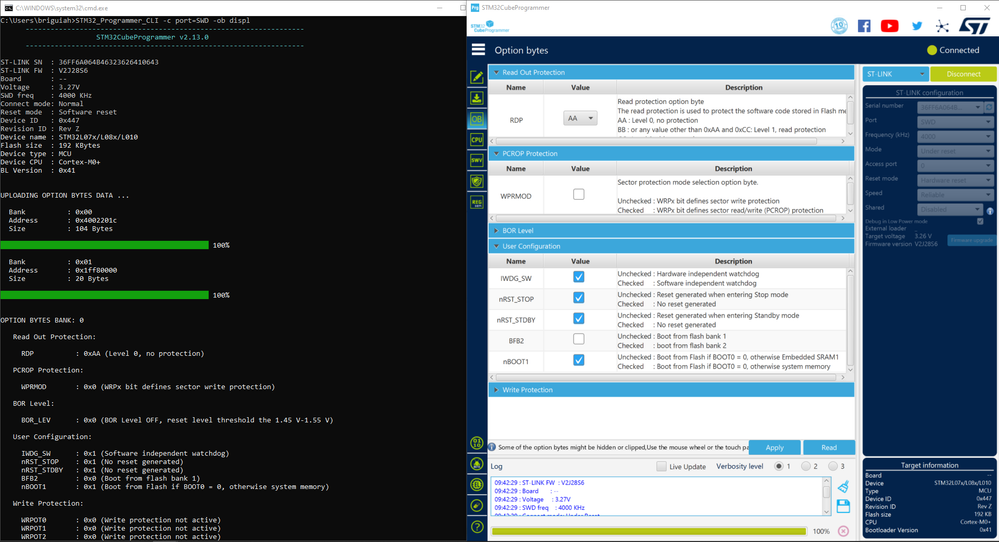

2023-03-16 11:35 PM
Oh sorry, I posted the wrong screenshot. I changed the screenshot which shows the output of the CLI and the GUI together. As you can see it shows contradictory results.

2023-03-21 6:32 AM
Hello @ADiet.1,
Sorry for the late reply, I missed the "contradictory results" part at first. Could you specify what are the contradictory results ?
Are you referring to the BFB2 value ?
Aziz
2023-03-23 1:49 AM
Hello @ADiet.1,
From my side for the same Option Bytes configuration.
Using 2.12.0 :
Using 2.13.0 :
There must be a reason behind us having different results. So to debug the situation further, I need to know if :
- You aren't modifying Options Bytes via GUI without hitting apply.
- You aren't modifying Option Bytes via your application (this shouldn't be an issue when using the same connection mode, but just to be sure).
