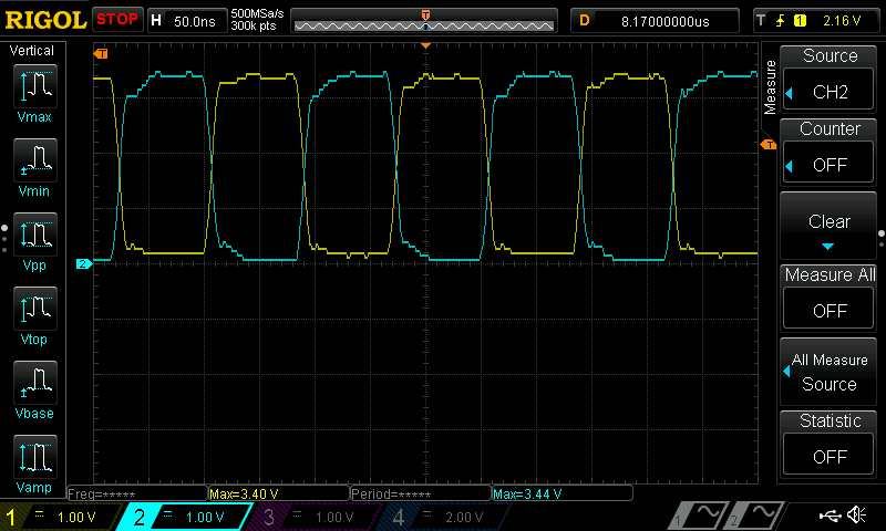

I have a custom board with a STM32H743ZI 144-pin processor. I can start the bootloader and the device is correctly recognized in the STM32CubeProgrammer as DFU in FS mode. I can read from device memory without issue, however when I try to download a firmware file to the device,it will always fail mid-transfer with the following error:

I repeated the exact same procedure on a NUCLEO-H743ZI2 that has the same processor and the download completes successfully.
My first guess was a hardware issue, so I used an oscilloscope to measure if there's any interference on the D+ and D- lines leading to the MCU pins, but based on my observation the signal looks fine and pretty much the same as on the Nucleo. On my design the D+ and D- are short, run along side each other and have an uninterrupted ground plane beneath them.

Hi @MLovr.1​
Can you please provide your chip revision ID, it can be read using STlinkUtility (top right panel), I will need your board and nucleo board chip revision ID.
This info will help me to reproduce you issue.
regards,
Houda
Custom board chip revision ID: 0x1003
Nucleo board chip revision ID: 0x2003

Houda GHABRI
Hi @MLovr.1​
I tested with two chip revision ID 0x1003 (revY) and 0x2001(revX) , for both revisions download is OK with STM32CubeProgrammer v2.4.0.
I made a check with exactly same file size than you.
My conclusion : It is not a STM32CubeProgrammer issue , it seems to be a Hardware issue.
