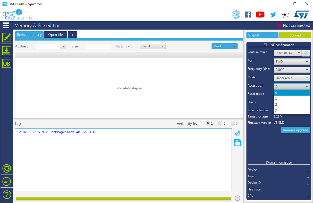

Hi guys, I disabled flashing core M7 in STM32CubeProgrammer option bytes to run just M4, but now I cant connect to the board and the tool says Error: No STM32 target found!. Is there some possibility how to reset the option bytes to again run M7?

By "disabled flashing core M7" do you mean you set BOOT_CM7=0?
If so, short BOOT0 to 3V3 during reset to enter the bootloader. Use bootloader functions to reset the option bytes.

Hi @binarybee​
Core M7 is connected to access port 0, Core M4 is connected to access port 3.
Since you disabled core M7, choose access port 3 in STM32CubeProgrammer to connect to M4, then you can reset the option bytes to again run M7.
You can refer to AN5286 for more details about STM32H7 dual core debugging.
Best regards
Bouraoui
‎2020-05-07 6:28 AM
Hi I tried it with port 3 but its still the same problem.

‎2020-05-08 4:48 AM
Hi @binarybee​
There is a limitation on Cube Programmer it will be fixed in next release, as alternative today you can use st-link utility.
Best regards,
Bouraoui

‎2020-05-08 4:56 AM
Hi yes I jumped to that limitation probably, with st link utility it worked and I can again reach M7 core.
