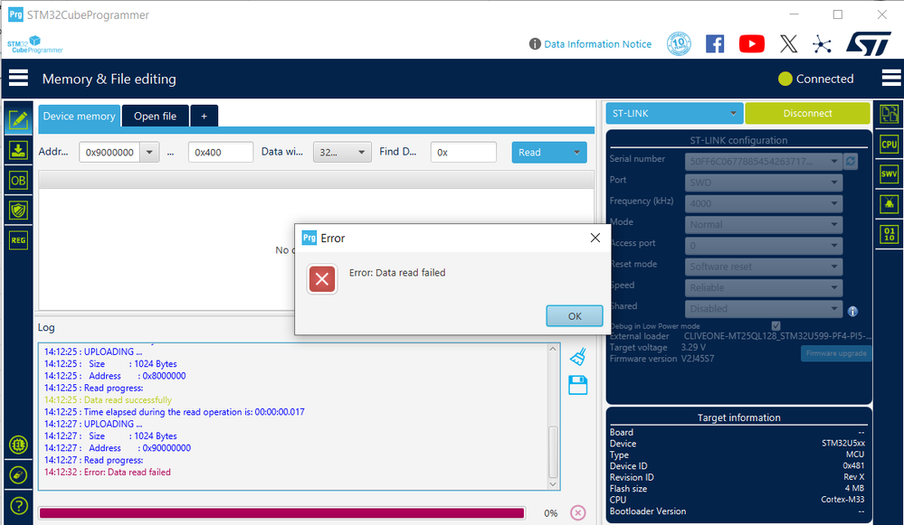

I have a custom board with an STM32U5A9 mcu with an external MT25QL128 flash for TouchGFX assets.
I have a working loader for IAR Embedded workbench and I'm trying to port it to work with the STM32CubeProgrammer.
When building as a normal project - that is a minimal cubemx project with just ospi and clocks enabled and with my ospi functions it runs fine, read/write/erase the flash without any issues.
However, when I move it to the loader framework the init function crashes - I believe in a hard fault or some kind. It's difficult to tell for certain since debugging the loader is tricky.
The cube programmer only tells me "Error: Data read failure".
I realized that if I return early from the Init, no error is issued and the flash only read zeros - which makes sense because the ospi is not initialized yet.
Thus I found out that the issue so far is on HAL_OSPI_MspInit function that was generated by cubemx.

‎2025-06-17 7:44 AM
Hi all,
I found the issue that I was having :)
For some reason the stm32programmer was calling the Init() function multiple times, and on the second run it crashed.
I solved the issue by testing whether the ospi was initialized or not
KeepInCompilation int Init()
if(READ_BIT(OCTOSPI1->CR, OCTOSPI_CR_EN)){
EnterMemoryMapMode();
return 1;
//perform the actual initialization
