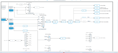

I am using an 8 MHz external oscillator and was planning to use a PLL to increase the system frequency. However, when I open the Clock Configuration tab in CubeMX, I don’t see any option for a PLL.
I’ve also shared a screenshot of the clock configuration where it’s clear that the PLL option is not available.
So my question is: Does the STM32C071CBT6 microcontroller support PLL with an external oscillator?

What makes you think the STM32C071CBT6 has a PLL?
There is no mention in the Datasheet
That would explain why CubeMX doesn't show it

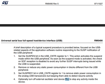

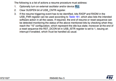

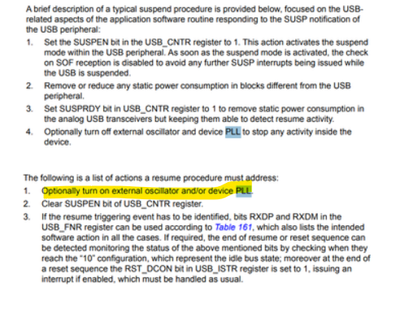

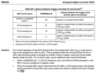

however, there are three mentions in the Reference Manual:
https://www.st.com/resource/en/reference_manual/rm0490-stm32c0-series-advanced-armbased-32bit-mcus-stmicroelectronics.pdf
via: https://www.st.com/en/microcontrollers-microprocessors/stm32c071cb.html#documentation
@STTwo-32 These look like copy-paste errors in the RM ?

Thank you for your quick response. I was reviewing the user manual and came across a statement that says, "Optionally turn ON external Oscillator and/or device PLL." This wording left me a bit confused, so I just wanted to confirm whether the PLL can actually be used in this case.
@Andrew NeilBy the way, if the CUBE MX software does not provide a configuration option for the PLL, then I will stop exploring this further for now.

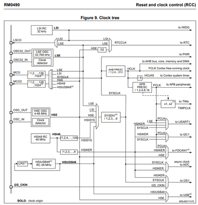

As noted earlier, those look like  copy-&-paste errors - and @STTwo-32 is looking into it.
If the PLL existed, it would be documented in the RM, and would appear in the Clock Tree:
https://www.st.com/resource/en/reference_manual/rm0490-stm32c0-series-advanced-armbased-32bit-mcus-stmicroelectronics.pdf#page=123
