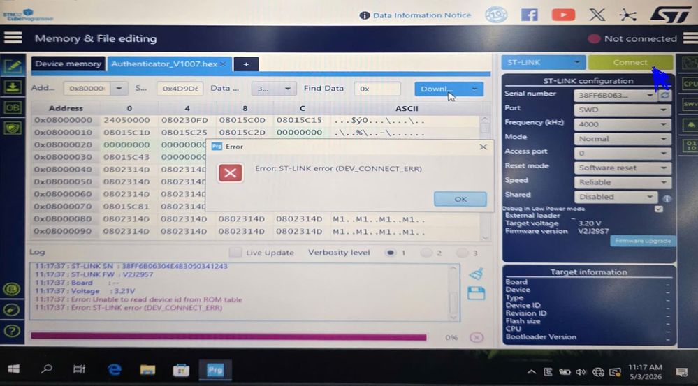

I am new member. We have issue . We have one computer ( PC ) , it is working normaly, but when we setup for other devices , SMT32cube programmer not working.  Plz caution  , one PC working normaly, we received from custommer. New device although we setting , they are not working.
They show error :
Error unable to read device id from rom table
Error ST-LINK error DEV_CONNECT_ERR
Plz help us.
Thank very much

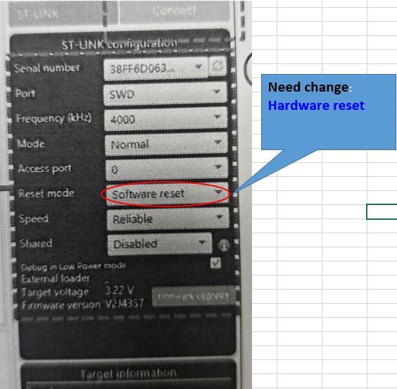

Thank you. after many attempts. we fixed our issue. Maybe our document is wrong. My document
Thank you your knowledge, I have been learning very much from it.

Welcome @VietNam_2026, to the community!
Your screenshot shows a very old firmware version V2J29S7 for your ST-LINK/V2, which suggests that you are using a clone. Please check this again. You are welcome to insert a photo of the front and back of the ST-LINK using the camera button.

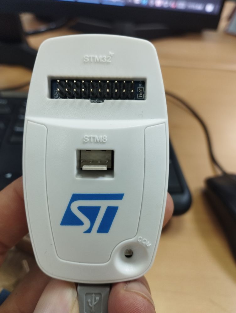

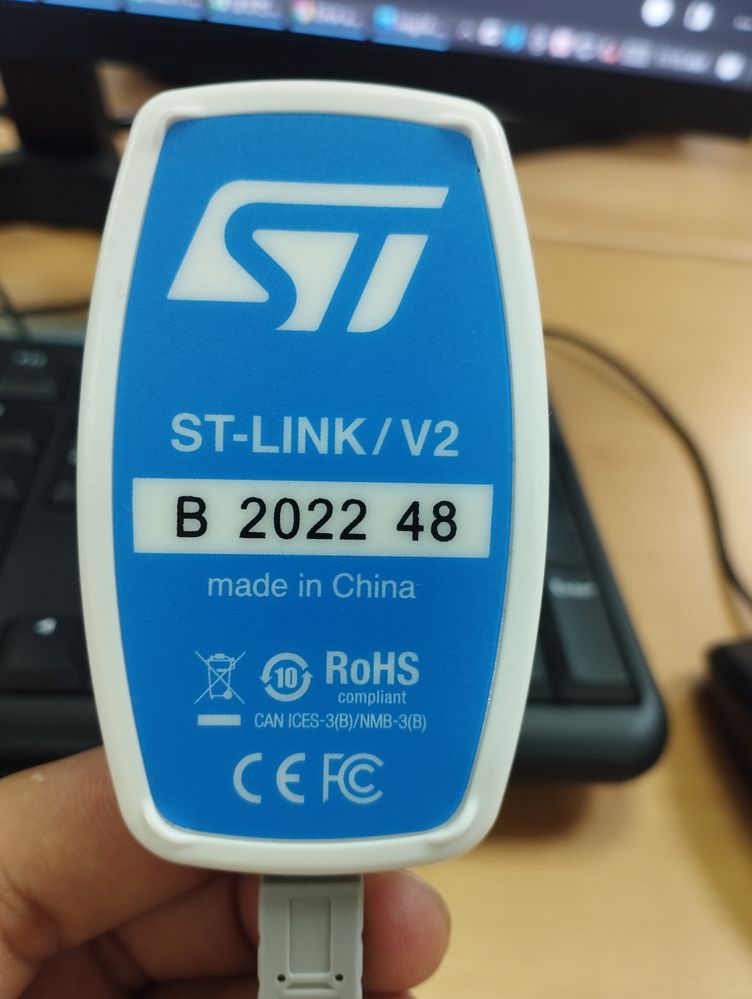

Thank you for your knowledge, under picture is device, we are using it.
IMG_20260306_111539.jpg\
That looks like an original ST-LINK/V2. Please start the firmware upgrade with the current STM32CubeProgrammer (light blue button in the middle right). After that, you should have the firmware version V2J46M33 or V2J47M34; otherwise, there is something wrong with your ST-LINK.
