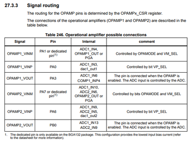

According to Table 246 in section 27.3.3 Signal Routing of the STM32U3 Reference Manual, I should be able to configure ADC1_IN6 as an ADC input when using OPAMP1, or ADC1_IN13/ADC2_IN9 when using OPAMP2 such that the output of the opamps are routed internally to the input of the ADC.

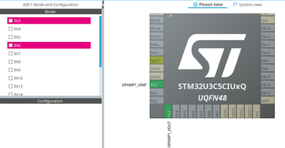

However, in CubeMX configuration for this device, enabling the Opamp in any capacity "red's out" the option to use the corresponding ADC input for any of these combinations. In this example, OPAMP1 is set to PGA Not Connected, and I am unable to  configure the ADC input on IN6.

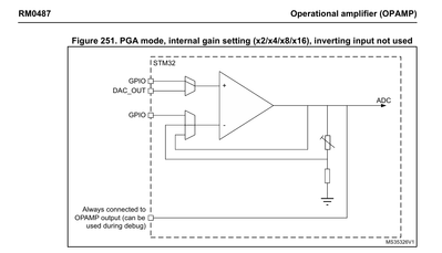

In STM32U3 OPAMP PGA mode, “PGA not connected” means only that the inverting  input not used. For OPAMP1, the external signal still enters through VINP on PA0(ADC1_IN3)  and the amplified result appears on PA3 (ADC1_IN6)
So CubeMX behavior is  correct.

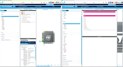

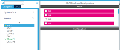

My confusion is that I am unable to enable the ADC to read from input channel 6 in CubeMX. I am less concerned about the particular operating mode of the Opamp, that was just an example to illustrate my issue.
Per this screenshot, I am unable to activate IN6 on ADC1 when OPAMP1 is enabled in any operating mode. At the very least, this means I cannot configure the other ADC parameters without enabling a second, unused channel.
If this is intended behaviour, how do I then enable the ADC peripheral to use the opamp output?
Thanks!
