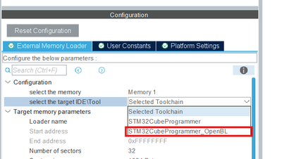

I'm working with the STM32H7S7L8 -DK and I need for final product to program the external OCTOSPI flash via usb DFU.
So using V2.20.0 Cube programmer i'm able to use external memory loader to read and program the flash using SWD
But using the USB i see the DFU  and before i select the good external memory laoder but when i click to connect i can only programm the internal flash of the STM32 when i try to read or program the OCTOSPI flash i have error.
Do you have any ideas
Thanks

You have to generate your own OBL loader for STM32H7S7L8-DK via CubeMX to be able to interface external memory via DFU (Since the loader is not included in STM32CubeProgrammer). Only OBL loaders for Nucleo-H7S3L8 are available by default.
PS: Conventional external loaders will work only via debug interfaces, for bootloader interfaces (such as USB), you'll need an OBL loader (E.g: MX25UW25645G_NUCLEO-H7S3L8-OBL.stldr

Hi @Aziz BRIGUI
Thanks for the reply.
Can you explain me the main differences that have been made to ext mem loader OBL vs the one created with cube mx.
So i can implement them in my project.
Thanks
Hi @Hamady,
Both types of loaders can be generated by CubeMX. You'll have to change this option:
I also recommend checking this wiki Getting started with External memory Manager and External memory loader - stm32mcu for further details.
