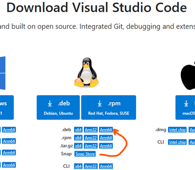

I am unable to inspect the device registers for my STM32U545 project. I can see the Cortex core Registers, and see them update as I step through the initialization.
The tooltip mentions an svd file, how can I check if it's set up correctly?
SamMiddleton
I have fixed things by switching from the snap version of VScode to the .deb version (which required temporarily changing the toolchain so that cmake could find ninja again).

could you please check in your STM32U5 dfp folder if you have any SVD folder with *.svd files in it
could you add also please your extension version and your DFP pack version
Hi. I have the extension pack version 3.8.0. How do I find the other things you mentioned?
Three weeks ago, I was doing some testing with a nucleo board and could see the registers fine. I then worked on other stuff until the boards got made, and now I can't see the registers in my testing project either.
SamMiddleton
@SamMiddleton
Discussing about this right ?
Well, I got the Snap through my distro's app center and the .deb from code.visualstudio.com, rather than from code.visualstudio.com/Download, but yes.
