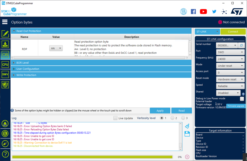

I have no idea where he got the value "55" but the upshot is I can't reset my OBs. When I try, I get this output from the programmer software:
  15:15:33 : Option byte command : -ob  RDP=170
  15:15:33 : PROGRAMMING OPTION BYTES AREA ...
  15:15:33 :   Bank          : 0x00
  15:15:33 :   Address       : 0x40023c14
  15:15:33 :   Size          : 12 Bytes
  15:15:52 : UPLOADING OPTION BYTES DATA ...
  15:15:52 :   Bank          : 0x00
  15:15:52 :   Address       : 0x40023c14
  15:15:52 :   Size          : 12 Bytes
  15:15:52 : Error: Uploading Option Bytes bank: 0 failed
  15:15:52 : Error: Reloading Option Bytes Data failed
  15:15:52 : Time elapsed during option Bytes configuration: 00:00:18.761
  15:15:52 : Error: Unable to get core ID
  15:15:52 : Warning: Connection to device 0x411 is lost
  15:15:52 : Disconnected from device.

0693W00000UFTC1QAP.pngHi Pirahna - thanks for the reply. What's wasn't clear to me is whether a value of 55 might have been interpreted as a CC, which (from my understanding) is a one way trip. I guess the passage from the reference manual you cited suggests not.
These are the settings I've used...thanks.
