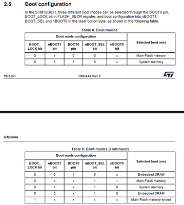

The STM32G0x1 series has the BOOT0 Pin disabled by default. To use the "legacy" Boot mode via BOOT0 You have to write thenBOOT_SEL Bit to 0. see Capter 2.5 of RM0444:
The BOOT via UART is working the first time only because the flash is empty.
Yess, thank you i was looking at the config but somehow didnt catch this, now only usb option taking my mind, working with others stms but never face this problem.

I don't think that the STM32G071 series has an USB controller, if You need USB (FS) you need to switch to the STM32G0B1 or STM32G0C1.
