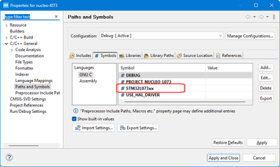

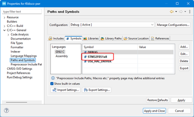

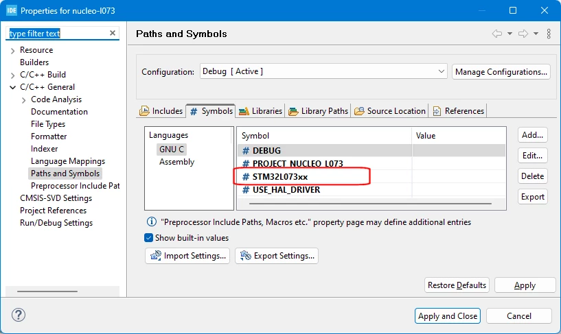

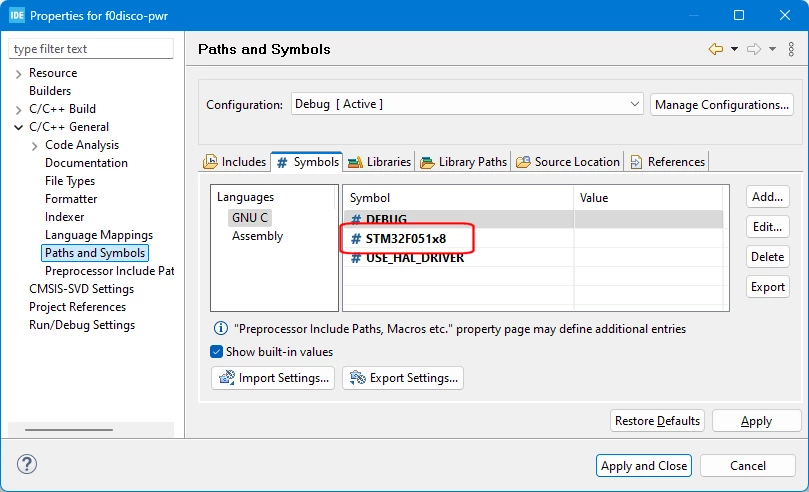

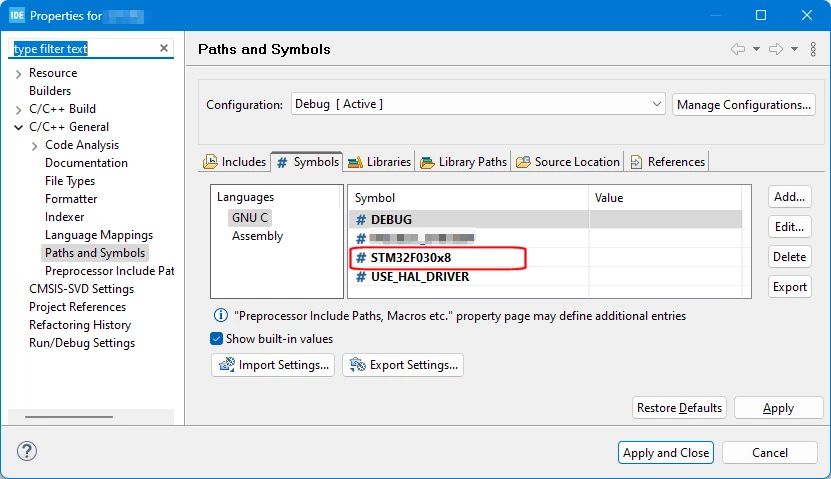

CubeIDE will automatically include a #define for the chip you're using; eg,
So you could use that to create your "family" macro; eg,
#if defined STM32F051x8 || defined STM32F030x8
#define STM32F0
#elif defined STM32L073xx
#define STM32L0
#else
#error "Unknown chip"
#endif
