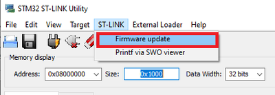

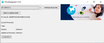

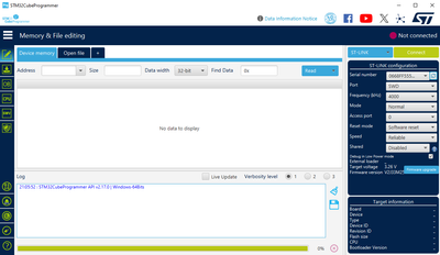

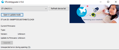

How can i solve this ? My board is a nucleo lnucleo-l476rg (genuine i think) but i cant do anything bc my cubeprogrammer dont works

I managed to update the firmware after removing the IDD jumper, but i didn't understand why, since i didn't read anything about having to remove this jumper for this ...

Did you tried another USB cable and/or another USB port?
Sometimes these are only charging cables or not suitable for USB data transfer.

Disconnect and reconnect the cable and try again.
Try to use STLink firmware upgrade downloadable from here: https://www.st.com/en/development-tools/stsw-link007.html
If It doesn't work, use STLINK utility (a depricated tool) to update the STlink firmware,
downloadable from here.
