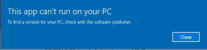

Thanks for your answer. i have already did this but i got this error as you can see0693W00000APAeLQAX.png0693W00000APAeMQAX.png

Hi @Dalhe.1​
Can you please copy the STM32CubeProgrammer folder under any user folder (Desktop for example) and try again?
Houda

Dalhe.1
/Hi @Houda GHABRI​
Many Thnx ... i just did as you said and it finnally worked !!
