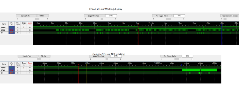

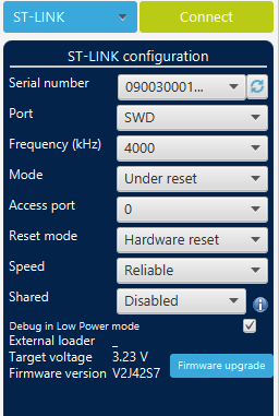

  I am having issues with programming a target board with a genuine ST-Link board (got from Farnell) . I have been using a cheap programmer that works, and as I have upgraded to the new IDE (from atollic) it fails to work , but still works on the STM32CubeProgrammer. The genuine ST-Link communicates with the PC, but cant connect to the Cube Programmer, while the cheap one works perfect. I have set the ST-Link Configuration to the below.I also have the images from the logic analyser during a connect sequence. As this is on the same target board and the cheap one work, I think this points to an issue with the genuine programmer. I managed to get a loan of another genuine one, and that too has the same effect. A noticeable difference the serial clock starts before the Reset line goes low , unlike the genuine no clock  till a good while after the reset line , and I assume it times out before this. Anyone any idea, I am totally baffled. I checked all the voltages on the board and are correct. The cheap one works on software reset as well as hardware.

Regarding  the IDE, I meant I upgraded to the latest CubeIDE from atollic because the new cubeMX  doesnt export the project correctly in atollic. The IDE doesnt work with either the new and cheap programmer. I got as far as the CubeProgrammer working with the cheap programmer, and stuck at this.  I dont understand why there is so much of a difference in the analyser output with both of them (as above).

We have an appropriate header, and long jumper wires. Actually, the cheap programmer lead is longer than the genuine. I have tried the lower speed too.  Anyone know why the difference in the analyser output? Looks like we get a not found due to the time the programmer sends out a clock pulse compared to the cheap one

Drop the speed. Perhaps look at what pull-up / down you have going on with your board vs SWCLK / SWDIO

Likely to find 4 MHz is TOO FAST for the CM0(+) cores to hack. ST's defaults can be too aggressive at times, and their fall-back and recovery game is also poor.
Might I suggest providing the analyzer plots at the same scale? Perhaps review the signal in the context of what's generated by the ST-LINK, and the expected/anticipated responses from the core, and square the circle from that perspective.

I have tried another computer, a new one we have with no ST software on it, and still the same. I tried all the speeds .
I couldnt display the genuine analyser output as it takes too long for the sck to start. Both are sampled at 10MHz , and noticed the genuine skl line is low , compared to high in the cheap model
