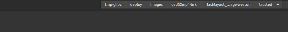

I try to compile my custom system, which is based on the Cubemx in the latest V4.0.0 ecosystem. I have a few problems
  1. lttng - how properly disable this package or what shall I add to compile it well
  2. After compilation is finished, the *.tsv files are not created - empty folders as following
  1. How to properly resolve issues with the license
WARNING: st-image-weston-1.0-r0 do_st_write_license_create_summary: IMG LIC SUM: File does not exist with open file /home/mw/openstlinux-5.15-yocto-kirkstone-mp1-v22.06.15/build-openstlinuxweston ...
I added a meta-layer to reproduce the compilation process if necessary.
git@github.com:voloviq/meta-osd32mp1-brk.git
The configuration process was based on
https://wiki.st.com/stm32mpu/wiki/How_to_create_your_own_machine
Thanks for any hints.

Hi @Marek Woloszczuk​ , @Gencay​
Know issue already reported twice in posts
I was following this how to create your own machine tutorial and got this warning and my flash_layout directory is empty.
and
meta-st-stmp32-addons variable issue ecosystem v4.0.0 - Kirksone
Solution is in last one and ST will provide a fix soon.
Apology for inconvenience.
Olivier
Gencay
August 25, 2022
@Michał Wołowik​ Hello, try this solution it worked for me for creating .tsv file.
MWoło.2
MWoło.2Author
Senior III
August 25, 2022
Confirmed, the solution from
https://community.st.com/s/question/0D53W00001fylFRSAY/metaststmp32addons-variable-issue-ecosystem-v400-kirkstone
works. The .tsv files are generated correctly.
Thanks
Olivier GALLIEN
Olivier GALLIENBest answer
August 26, 2022
Hi @Gencay​ , @Michał Wołowik​
Thanks for feedbacks ! .
A minor release 4.0.2 of the Distribution package has already been issued on Github containing the fix.
Olivier
