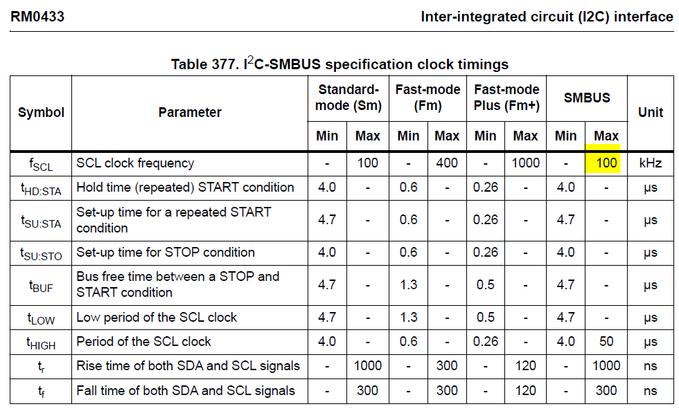

Why is the SMBus-two-wire interface limited to 100kHz clock,
FStra.9
I'm using the STM32H743 and the it will not allow me to choose fast mode for a 400kHz clock speed. Is that a bug in the IDE?
The reference manual lists max SMBus frequency as 100kHz so CubeMX is probably just respecting that.
This presentation says it works at higher speeds:
https://www.st.com/resource/en/application_note/dm00118362-stm32-smbuspmbus-embedded-software-expansion-for-stm32cube-stmicroelectronics.pdf
So probably if you changed the clock initialization manually it would work. But it's not going to work with HAL due to this define:
#define IS_SMBUS_CLOCK_SPEED(SPEED)                (((SPEED) > 0U) && ((SPEED) <= 100000U))
