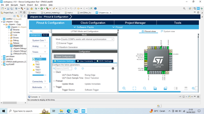

I want to count the pulses coming from COMP2's output using LPTIM1. However, when I send it to Tera Term, the displayed LPTIM value is consistently 1, and it doesn't match the COMP2 output.
Has anyone had this problem? How did you resolve it?
I would greatly appreciate it if there is an expert who can assist in fixing this issue.
I am using STM32Cube IDE Version: 1.10.1.
My MCU is STM32L051C8T, on a custom board

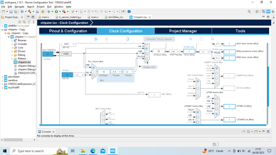

This is my clock
This my LPTIM configuration

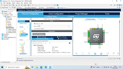

this COMP configuration
this my code

    Hello @Valen_id
    maybe as a first step, verify that the LPTIM counter is running; read the value of the counter (since it's always showing value 1)

    Read out and check/post content of COMP and LPTIM registers.
    Valen_idAuthor
    August 5, 2023
    Thank you for your reply, how do I get it
    waclawek.jan
    August 5, 2023
    In debugger, you should have some kind of "peripherals view" window or something similar. I don't use CubeIDE so don't know where.
    [EDIT] UM2609 chapter 5 Special Function Registers (SFRs)
    Valen_idAuthor
    August 6, 2023
    Is this what is meant?
    waclawek.jan
    August 6, 2023
    Yes.
