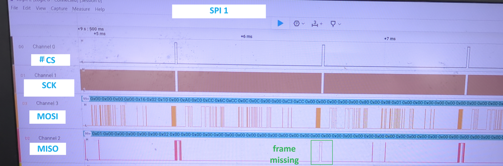

I am herewith attaching the snap shot of logic analyzer (for SPI 1). Similar for SPI2.
Apart from MISO, everything looks fine to the extent that I can see. Can't resolve detail around CS edges.
If CS/SCK/MOSI signal are correct, nothing is wrong on the master/STM32 side.

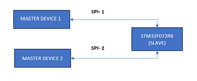

What external device are you interfacing with? Are you meeting all of its specifications for data transfer?
Hi Guru,
In our application STM32 is SPI slave mode, Above is reference block diagram, attached above is SPI-1 and SPI-2 waveforms in previous chat
Kindly guide as on Data transfer From Slave to master (MISO)
We are getting alternate frame miss in MISO as you can see in above waveform snaps in previous chain
As you mentioned CS/SCK/MOSI signal are correct, nothing is wrong on the master side -----> yes
We are facing issue in slave (STM32F072) data transfer to Master device
Quick solutions preferred. Kindly reply asap
If you need to have short call also, we are ready to explain the issues
I think it's a program logic issue. You're starting SPI1 transfer when SPI1_CS is low. Surely that's too late. The slave needs to be ready prior to the start of the transaction. Typically, one would resynchronize/queue the data on the CS rising edge.
