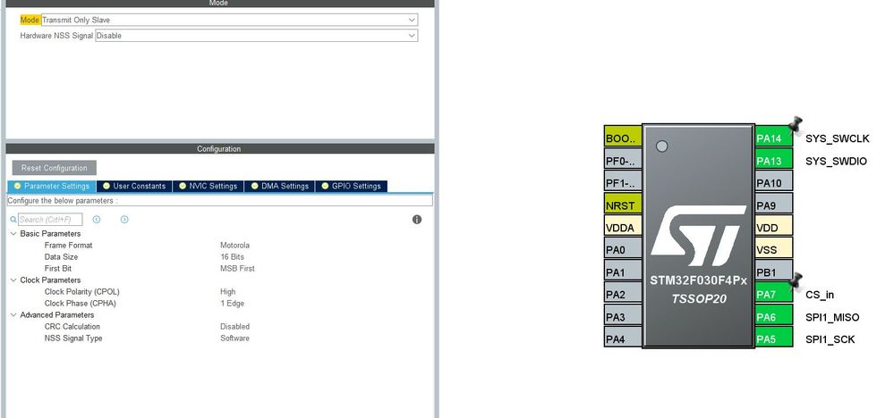

There was a problem with sending data via SPI. After the successful transmission of the first package, the second and further package arrive shifted by one bit. The whole package shifts. Now I fixed the problem by reinitializing the SPI after sending the package, but this is a bad solution to the problem.
I also noticed that after shifting the most significant bit, the MISO bus changes (seen in the video 4 sec and 28 sec). I tried changing CPOL and CPHA, but it did not produce results.
I generate the code on CubeMX. I use the HAL_SPI_Transmit function for maximum simplicity.
Board stm32f030f4p6.
I attach a video demonstrating the displacement, also a project on CubeMX.
sample code:
